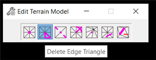

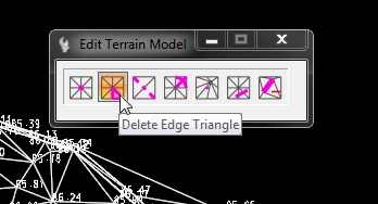

Unable to Delete Triangle Edges
Product(s):OpenRoads Designer
Version(s):10.04.00.48
Area: Terrain
The Edit Terrain Model > Delete Triangle Edge command does not work.

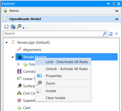

Deactivate the rules on the Terrain Model by right-clicking on Terrain Models in Explorer and selecting “Lock-Deactivate All Rules”.
