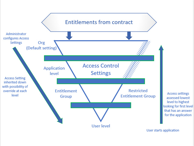

Access controls are available to the organization’s license administrator to help control which products users should have access to. Access can be controlled at multiple levels.
  1. Default access settings for all products in an Entitlement country
  2. Product-level access settings for an entitlement country
  3. Entitlement group access settings
  4. User-level access settings
When a user requests an entitlement to run a product, SES assesses the access settings from the user level moving up the hierarchy until there is an access setting found that applies to the user. If there is an access setting for the product for that specific user at the User level, that will be the access setting used. If not, SES will look for any group that the user is associated with that includes an access control setting for the product in question.
The access settings are inherited down as a hierarchy and are assessed from the bottom (user-level) to the top (organization-level) to look for the setting that product access setting that applies to the user. The following should help illustrate the concept.

It’s important to note that users can be in multiple Entitlement groups.  In such cases, a user’s entitlements are considered cumulative across all of their groups, so if the user is allowed to use a product because of settings in any one of their groups, then they are allowed to use the product.
Referring back to the illustration of Access control hierarchy, it’s also worth pointing out the difference in behavior for an Entitlement group that is restricted to a specific set of products versus one that is not restricted, meaning it includes all of the products marked as Allowed for use in the Entitlement country plus the list defined in the Allowed Products list in the group.  This difference in behavior is enabled with the “Include Allowed Products from <Entitlement country>” option in the Entitlement group.
By default, Entitlement groups are configured as Restricted groups with the Allowed Products list defining all the products that the group’s users have access to.
