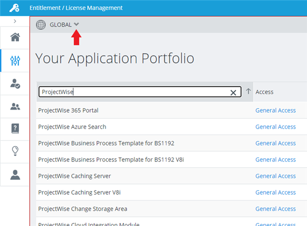

  5. Choose Global from the Country drop-down menu in the upper left as shown below and optionally filter on products such as ProjectWise.
    Screenshot of Country selection
