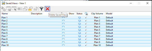

When creating plan sheets, the sheet model names are sequential, regardless if previous sheet models have been deleted. I deleted all of the drawing & sheet models from the file, then created the sheets again    and view numbers started after the last ones created. How I can redo sheets without changing the numbers?
Answer:
After deleting the drawing and sheet models, delete the saved views then recut sheets.
By default, the numeral in the Create Drawing>Name dialogue will sequentially follow the next number defined in the saved view. In this case, that number is 11.
