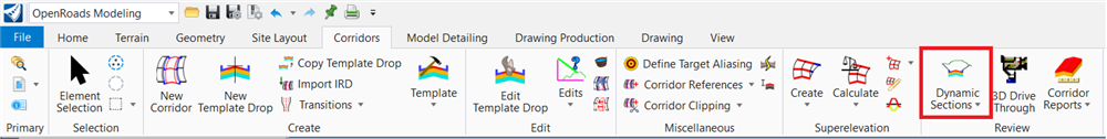

Use the tool OpenRoads Modeling > Corridors > Review > Dynamic Sections > Open Cross Section View.
From there, locate the alignment, set the Left/Right offset and cross section Interval. Then, open a new view window to place the Cross Sections.
