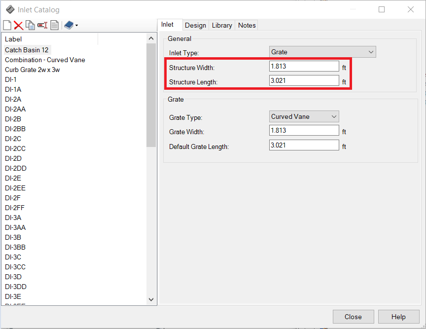

Under Subsurface Utilities > Components > Catalog > Inlet Catalog, with the Inlet Type set to Grate, what are the Structure Width and Structure Length defining?
Answer:
Structure Width and Structure Length define the inside vault dimensions.
