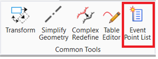

- Click OpenRoads Modeling > Geometry > Common Tools > Event Point List

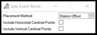

- Set your Placement Method to Station Offset
- Click within the dialog box to add by station offset

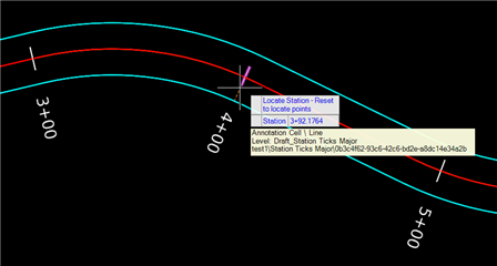

- Snap to the Centerline Station you want. Set offset to zero. Data point to accept. You can see in the below screenshot snapping to the 4+00 centerline creates an event point along the edge of pavement at station at 3+92.
- Continue until all event points are created.
