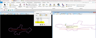

Can we move complete terrain in Z direction?
Answer:
We can use Transform option to move terrain in Z direction as shown in the below snapshot.
