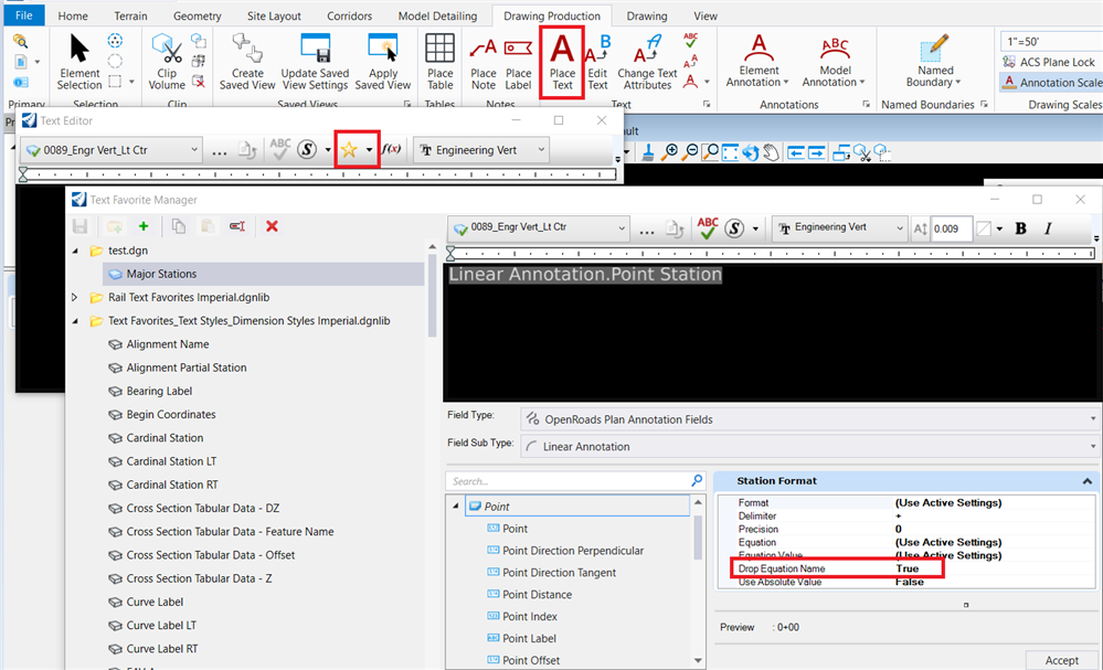

Question:
How do I remove the Station Equation name when annotating my alignment?
Answer:
If you already have a Text Favorite assigned to your Annotation Definition, then you can edit it within the dgnlib. Open the dgnlib. Go to the Place Text window, click the Text Favorite pull down and select Manage. Navigate to the Text Favorite for the stationing. Set Drop Equation Name to True.
If you need to create a Text Favorite, then on the Place Text window click Insert Field and the OpenRoads Plan Annotation Fields from the pull down. You want the Point > Point Station field. Then set the Drop Equation Name to True.
