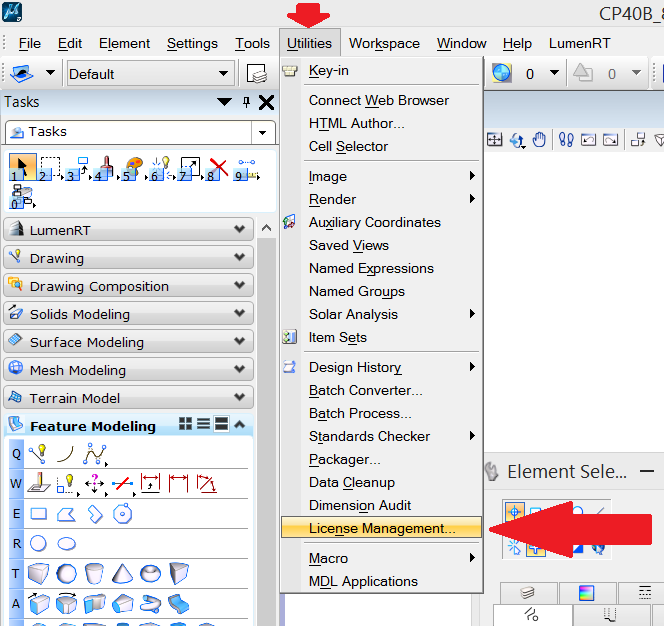

  1. License Manager opens in several products (e.g. MicroStation V8i) via Utilities > License Management... menu

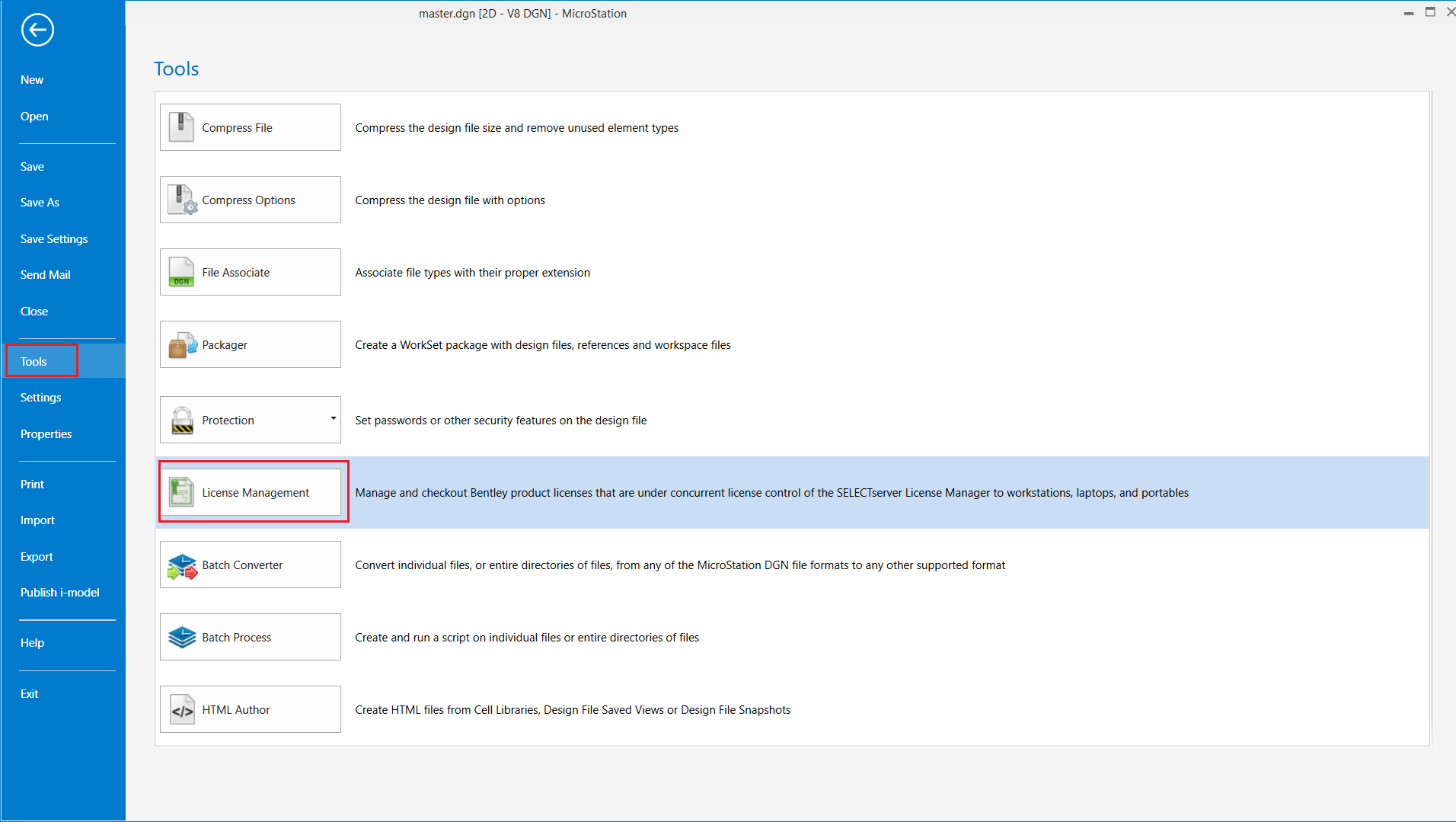

  2. In MicroStation CONNECT Edtition go to File > Tools > License Management:
