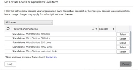

Activating a CivilStorm, SewerCAD, and SewerGEMS license for the first time
When you activate a CivilStorm, SewerCAD, and SewerGEMS license for the first time, checks are made to see if you have a license available for it, and how many links it is for. You will see a dialog similar to this:
Once you have clicked Select to choose the license that you want to use, this choice is remembered and will be used when you activate that license again in subsequent sessions of the Open X Designer product. If you need to change the number of links that you have selected at any point in the future, then you can do so by using the Bentley Licensing Tool:
On the Bentley Licensing Tool dialog, click Tools > Select Feature Level. The Feature Level Selector dialog is displayed, and you can select the appropriate product and feature level for the number of links that you need.
