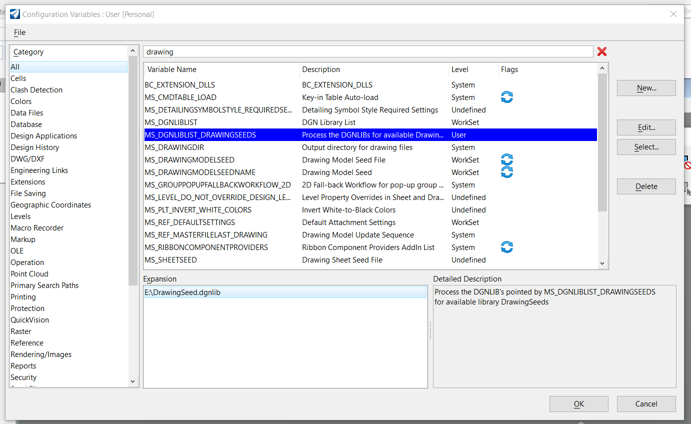

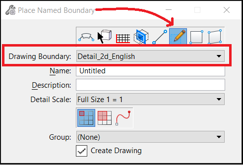

What variable populates the From Drawing Boundary's "Drawing Boundary" pull down?
Product(s):OpenRoads Designer
Version(s):10.00.00.120+
Area: Drawing Production
Question:
What variable populates the Place Named Boundary > From Drawing Boundary's "Drawing Boundary" pull down?
Answer:
File > Settings > Configuration > Configuration Variables > MS_DGNLIBLIST_DRAWINGSEEDS can be used to customize this pull down. The default location of the dgnlib that prepopulates the Drawing Boundary pulldown is located here: C:\Program Files\Bentley\OpenRoads Designer CONNECT Edition\OpenRoadsDesigner\Default\Dgnlib\DrawComp\en.
