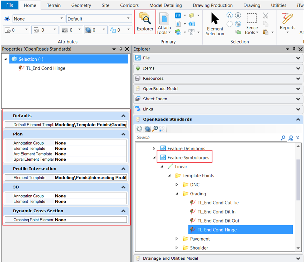

To modify, go to Explorer > OpenRoads Standards > dgn name > Feature Symbologies > Select the one you want to edit. Open Properties and edit within the Properties window.
