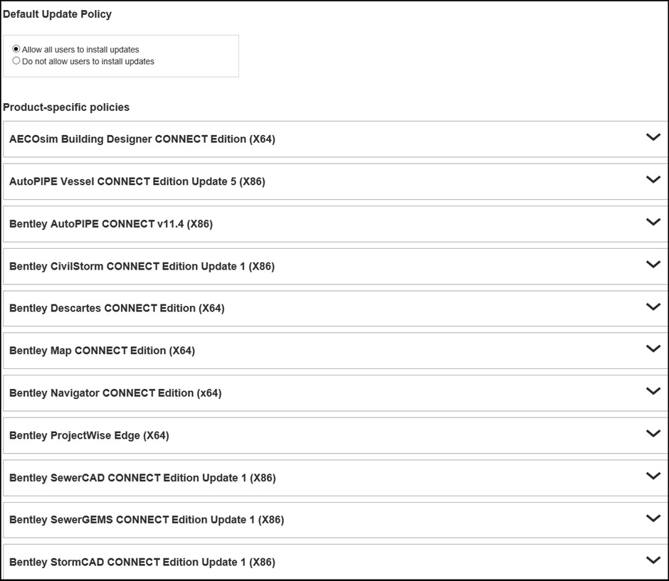

The Software Administration home page will now be displayed.  This page contains a list of all the available applications and the policy for updating each of them, which can either be a Global or individual setting.

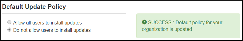

An Administrator can set a Default Update Policy to either allow all users to install updates or to block all users from updating.
3. Select the appropriate option. Once the option is selected it will be confirmed.

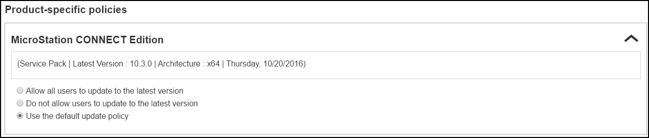

After a Default Update Policy has been set, individual overrides can be applied to each application as needed.
4. Select the down arrow associated to the product to view the available options.
