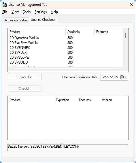

Once in the License Checkout dialog:
a. Highlight the product in the top box.
b. Select a Check Out Expiration Date from the drop down.  A license can be checked out up to the expiration of the SELECT Contract, or up to 5 years if the site is Non-SELECT.
c. Click the CheckOut Button.

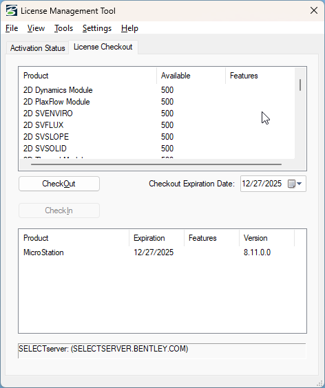

This will launch the Checkout Settings dialog Box, in the Checkout Settings Dialog:
a. Enter your Email Address.
b. Enter the version number, if it did not auto-populate.
c. Click OK.
You should receive a message stating the Checkout was successful. Click Ok.
Then the Checked-Out license will move to the bottom box.

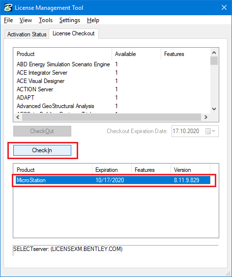

Check In
1. The Checked-Out license will appear in the bottom box.
2. Highlight the product in the bottom box.
3. Click CheckIn.
After 24 hours the license can be issued again for another maximum 365 days.
