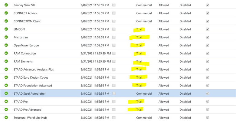

License Type is Trial instead of Commercial.

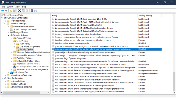

Ask IT to ensure the following group policy setting for FIPS compliant algorithms is not enabled on the workstation since it prevents CONNECTION Client from using an encryption algorithm for communication with Bentley:
Screenshot of FIPS group policy setting
If the above doesn't fix your issue, please log a Service Request via our online Service Ticket Manager http://apps.bentley.com/srmanager/. Screenshots of the Bentley Licensing Tool (two tabs - Entitlements and Product Status), along with logs will be needed to review further.
