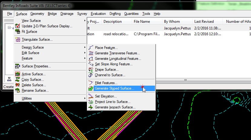

What is the OpenRoads Equivalent to the 'Generate Sloped Surface' Command in Native InRoads?
Version(s):08.11.09+
Area: 3D Geometry
Question:
How do you generate a sloped surface using OpenRoads tools?  This was previously accomplished using the Generate Sloped Surface command in the native InRoads product. Is there an equivalent OpenRoads tool?

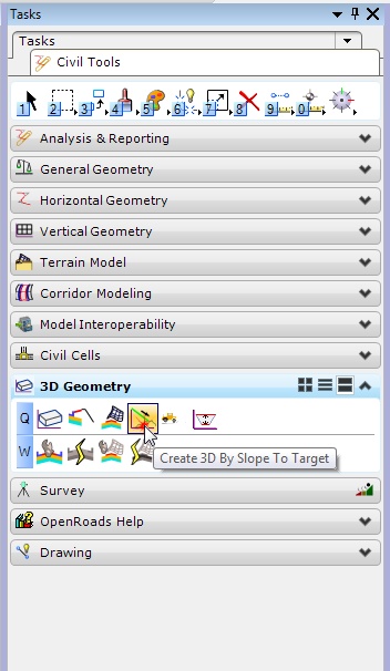

Answer:
 The tool used to generate a sloped surface in OpenRoads is the Create 3D By Slope To Target tool located in the 3D Geometry section of the Civil Tools Tasks.  This tool creates a 3D element computed from a linear element to a surface.
The video at the link below provides a demonstration of this tool.
communities.bentley.com/.../26533.video-designing-a-building-pad
