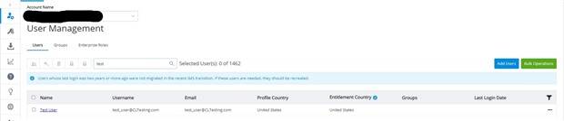

1. From the User Management search for the user

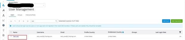

2.  Next, click on the user name

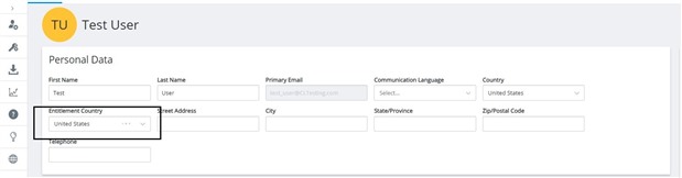

3. Click on the Edit option.  You can now edit the user's address and Entitlement Country

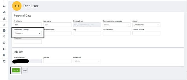

4. Correct the Entitlement Country
5. Click on Submit Button

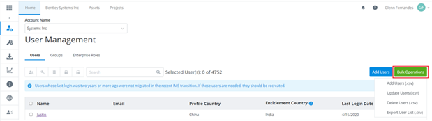

Administrators now have the ability to update the entitlement country of a group of users via CSV file.
1. From the home screen in User Management click Bulk Operations
2.  Select Update Users

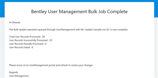

6. Once the job is completed, an email will be sent to the Account Administrator.
