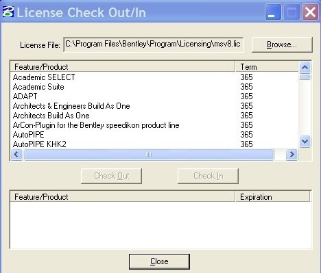

User cannot see MicroStation listed under Feature/Product in the License Check Out/In dialog.
Pre-XM license client “License Check Out/In dialog” has a limitation in displaying number of rows.

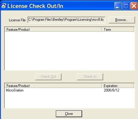

To fix this, SELECT Site Administrator need to restrict the list of licenses available for check out. Please check this article How do I set up or prevent license checkouts?
After limiting the Check Out product list (disable), only the required products (enable) are available under the Feature/Product list.
Please check this article Client Check In and Out Instructions for Pre-XM and check out the product.
