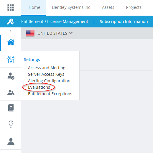

- Choose your organization name at the top to go to the Subscription Services Portal: https://subscriptionservices.bentley.com/
- In the left navigation menu, choose "Evaluations" (under "Settings")

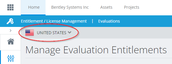

Note that Evaluations are Country Specific, choose the correct country from the dropdown -
