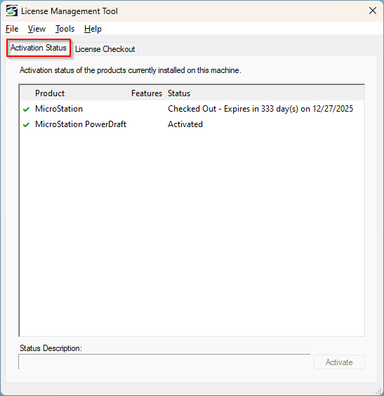

Confirm your Activation Status
Most Bentley Products will show a status of “Activated” once they are properly activated. However, keep in mind that there are some exceptions such as RAM and STAAD. If you would like to know more about what each of the different Activation Status' mean, please see Product Activation Modes of Behavior.
To confirm your Activation Status, open the License Management Tool. In newer releases, the default screen will show the Activation Status.
In older versions, you will need to go to Tools>Activation Status.
