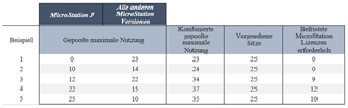

Examples:
For the purposes of the usage examples referenced below, assume that you have 20 perpetual licenses of MicroStation covered under SELECT and 5 active pre-paid annual subscriptions of MicroStation, for a total of 25 covered MicroStation seats.
