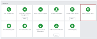

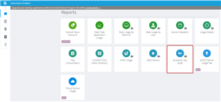

Users with at least one of the following roles are able to access the Subscription Analytics:
1. Go to https://connect.bentley.com and Sign In.
2. Click on your company name at the top to access the Subscription Services Portal.
3. Click the tile that reads Subscription Analytics.
4. The Subscription Analytics will open on a landing page with tiles of the available reports. Click "Activation Key Audit" to see the site activation keys associated to your account -
Your site activation key(s) will be visible in the report.

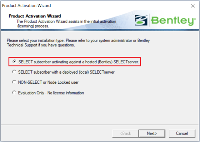

Once in the Product Activation Wizard, you are given the following options:
“SELECT subscriber activating against a hosted (Bentley) SELECT Server.”
"SELECT subscriber with a deployed (local) SELECT server.”
“NON-SELECT or Node locked user”
“Evaluation Only – No license information”
1. Verify that you have selected: SELECT subscriber activating against a hosted (Bentley) SELECTserver

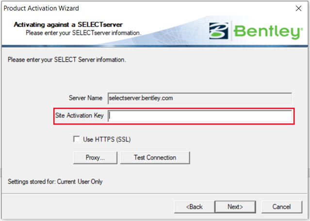

2. Once selected, click Next> in the bottom right corner. When selecting the "SELECT subscriber activating against a hosted (Bentley) SELECTserver," the server name will be filled in by default.
3. Fill in the Site Activation Key in the Site Activation Key box.
*Please Note: Due to the length of the site activation key, it is recommended that each user copy and paste the information directly into the license management tool. Also, be sure there are no extra spaces before or after the server name and site activation key as this can prevent a proper activation.
4. Once completed, select Next>

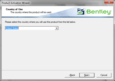

5. Depending on what version of software in being installed, the country where the product will be in use may have to be selected.
6. Once a country of use is selected, Next>

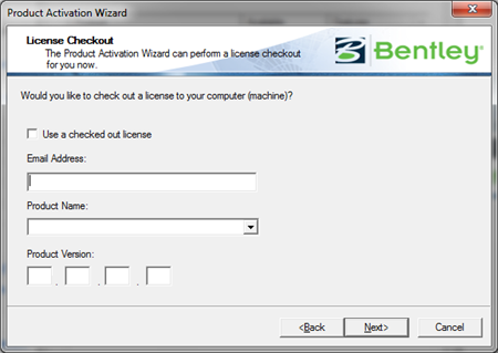

The following screen is titled "License Checkout".
*Please note: Using a checked out license is only intended if you will be without an internet connection for an extended period of time. If connected to the internet, a checked out license is not needed.
7. Select Next> to Finish activation.
