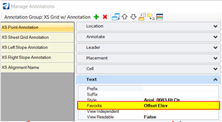

  2. ANNOTATION GROUP
    1. Is the point included in the Location Annotation Filter?
      1. Watch this video for help on troubleshooting the Location Annotation Filter.
      2. How to edit a Cross Section Annotation Group (Start watching at 10:45 for Cross Sections) also provides additional clarity on an Annotation XS Point Definition.

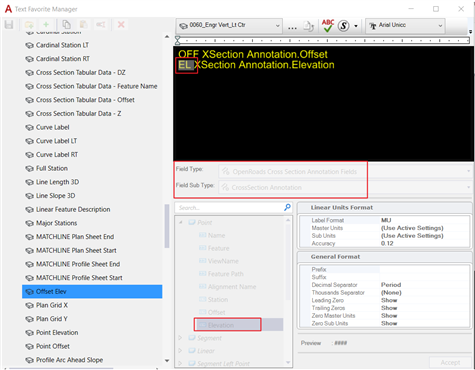

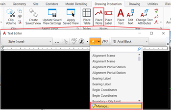

  3. TEXT FAVORITES
    1. Is the Annotation XS Point Definition's Favorite pointing to a Text Favorite that exists?
      1. It could be that the Favorite is pointing to a Text Favorite that doesn't exist in the model. This has happened when Text Favorites have been renamed, moved within the tree structure, or deleted and the program did not update the information properly. You will need to remap the Favorite row to the correct Text Favorite.
    2. Are the Text Favorites used by the Annotation Group set up to display the correct information about the point?
      1. Open the Text Favorite Manager and navigate to the Text Favorite that the Annotation Definition uses to make sure it is using the correct Field Types and formatting you need. You can open the dgnlib to make edits to the Text Favorite. This wiki covers how to create a Text Favorite
