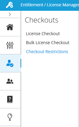

Checkout Restrictions allows an administrator or co-administrator to set limits on the ability for users to check out Bentley products for each country.
To navigate to Checkout Restrictions from Entitlement Management, select Checkout Restrictions from the left navigation menu.

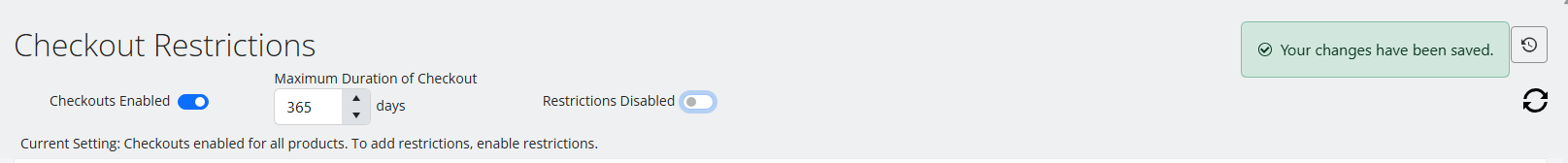

The status of your Checkout Restrictions is displayed at the top of this page
Disable and Enable Checkouts
By default, checkouts will be enabled. To disable all checkouts, simply toggle the Checkouts Enabled toggle.
When Checkouts have been disabled, the toggle will change to read Checkouts Disabled. The options for Maximum Duration of Checkout and to enable Restrictions will be unavailable. To enable checkouts, click the Checkouts Disabled toggle.
This does not disable checkouts that already exist. This only disables new checkouts from being created.

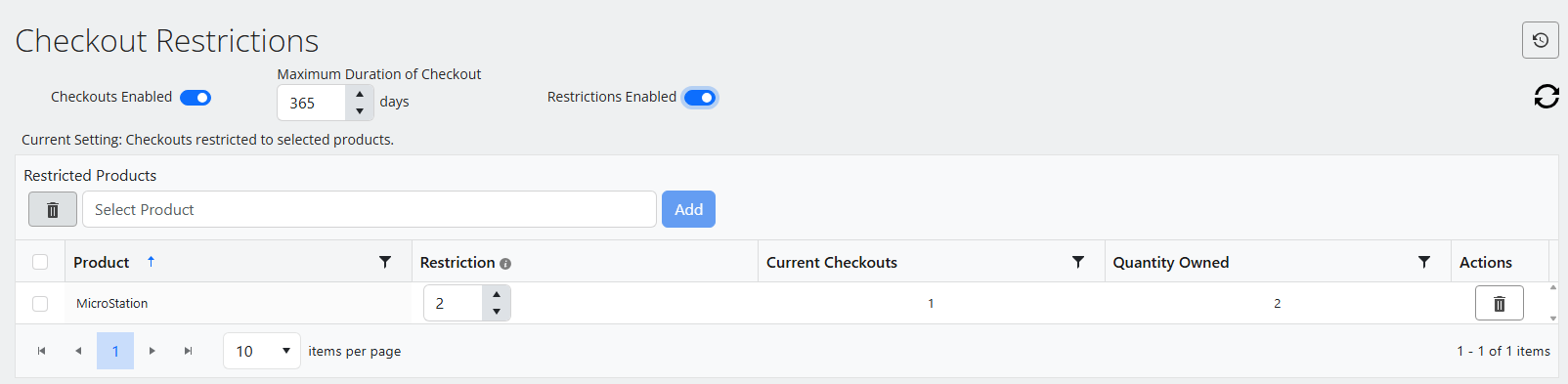

Set Maximum Checkout Duration
With Checkouts Enabled, you may adjust the length of time that a user may check out a license. This applies to all products.
The maximum value you may enter here is 365 days. If an invalid value is entered, the box will highlight in red and will automatically reset to the previous valid value.

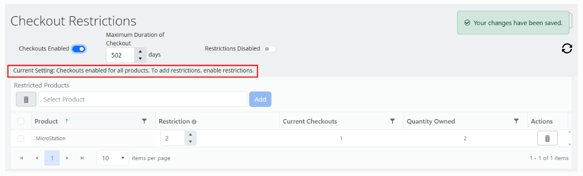

Enable Restrictions
With Checkouts Enabled, you may enable restrictions on individual products. Simply click the Restrictions Disabled toggle to grant the ability to create restrictions on individual products.
When restrictions are enabled, the Current Setting text will be in red to highlight that restrictions have not been added.

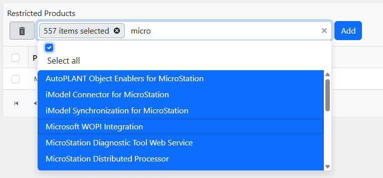

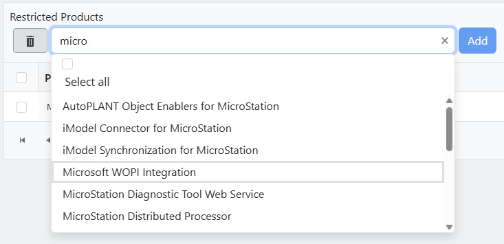

Restrict a Product
With Restrictions Enabled, use the Select Product search bar to find an product. You may use the Select all checkbox to select all products at once. To select specific products, begin typing any part of the product name and predictive text will show options that fit your criteria as you type.
When you have clicked on an product, the search bar will keep track of your selections. You may click the X to un-select it, begin typing again to select more products, or click the Add button.
After you have finished making your selections and clicked Add, your selected products will now be available for restrictions. In this case, only two products have been selected.

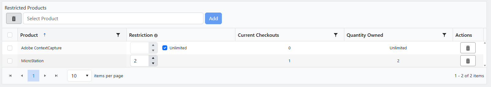

Column Description
Product Product name.
Restriction Set the number of simultaneous checkouts allowed. This number cannot exceed the Current Checkouts or Quantity Owned. If it needs to be set larger than Current Checkouts, ask users to check their license back in and click the Refresh icon in the top right of the page.
Current Checkouts Number of checkouts currently active for the product. This value is checked when the page is loaded. Click on the Refresh icon in the top-right of the page to check for the latest value.
Quantity Owned Number of licenses owned for the product.
Actions Actions available for the product. Currently, only Delete is present.

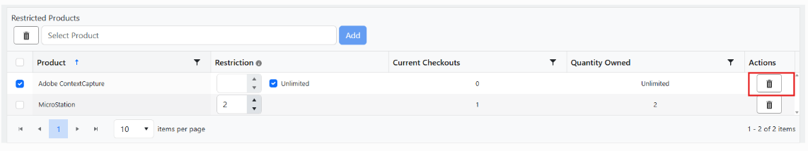

Remove Restrictions on a Product
To remove checkout restrictions on an product, click the trash can icon at the end of the row. To remove checkout restrictions for multiple products at once, use the checkboxes and the trash can icon near the search box.

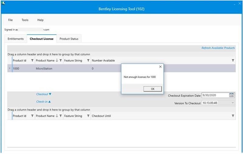

What happens if a user tries to check out a license but checkouts are disabled or the restriction has been reached?
The user will receive a message in the Bentley Licensing Tool which reads "Not enough licenses for [Product ID]"
