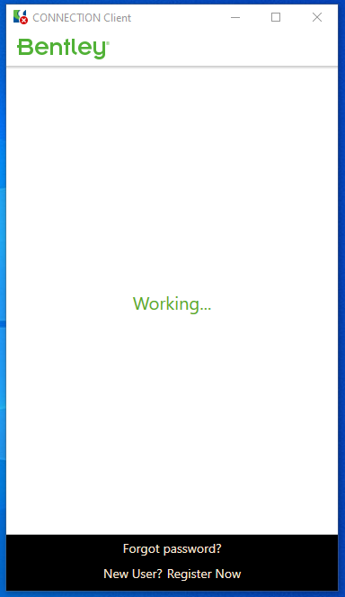

After upgrading to CONNECTION Client 11.00.02.16 or later, end users observe a CONNECTION Client window that opens and displays a Working message but never displays the sign-in page.
Screenshot of Working message
