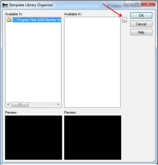

  3. In the Create Template dialog, select Tools > Template Library Organizer.
  4. Open the IRD or ITL that you wish to copy the template from by selecting the browse button on the Template LIbrary Organizer:

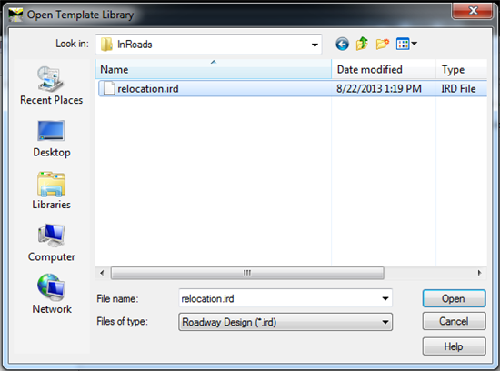

  5. In the Open Template Library dialog, set the Files of type to either "Template Library (*.itl) or "Roadway Design (*.ird)" and select the file that contains the template you wish to copy.  Click Open.

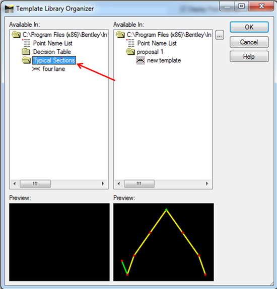

  6. On the left-hand pane, navigate to the folder in the template library that you wish to copy the template into.

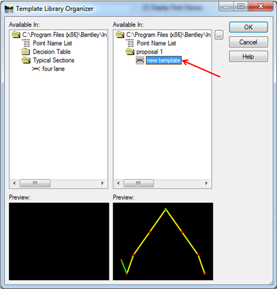

  7. On the right-hand pane, highlight the template you wish to copy.  Drag and drop this template into the desired folder on the left-hand pane.
