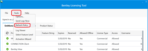

B) For CONNECTION Client v. 25.xx and older:
1. Open the Bentley Licensing Tool
Option 1 - from CONNECTION Client
Using the 'License Tool' item in the CONNECTION Client drop-down menu (starting from version 11.00.05.34):
License Tool menu item in CONNECTION Client
Option 2 - from the Windows Start or Search
1. Open the Windows Start menu.
2. Type "Bentley Licensing".
3. Select Bentley Licensing Tool from the search results that appear.
Option 3 - from the file location
Open the executable directly from the file location, which by default is: C:\Program Files\Common Files\Bentley Shared\CONNECTION Client\LicService\Bentley.Licensing.LicenseTool.exe
2. Refresh the Policy
Process the following: TOOLS > Send Logs Now and then TOOLS > Refresh Policy
Screenshot of Refresh Policy option in Bentley Licensing Tool
NOTE:
If the product application is already open when the policy is refreshed, the changes will not take effect until after the application is closed on the machine.
