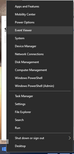

  1. Right-click on the Windows Start menu, and select Event Viewer from the contextual menu.
    Screenshot of Event Viewer listing in Start menu

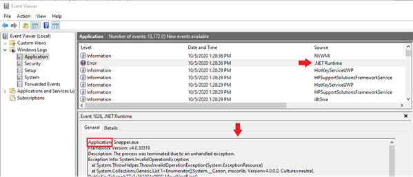

  2. In the Event Viewer window that appears, expand Windows Logs, and select Applications.
  3. Note any error listings with a Source value of .NET Runtime as shown below.
  4. Select such listings, and examine the Application value under the General tab as highlighted below.
