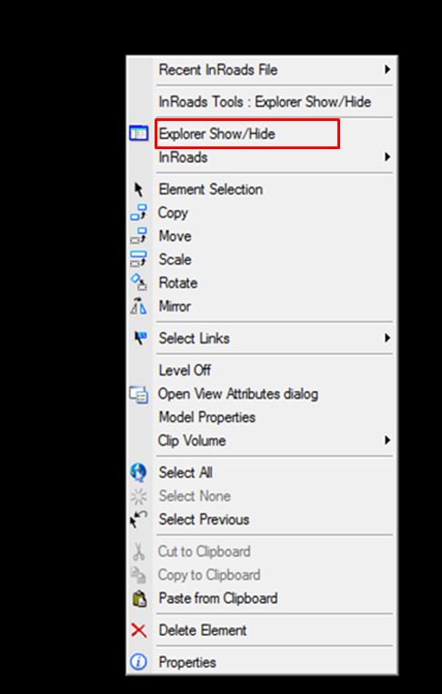

Alternatively, you can perform a long right click in the Design Model to bring up a menu.  On this menu, you will see a shortcut to Explorer Show/Hide.
