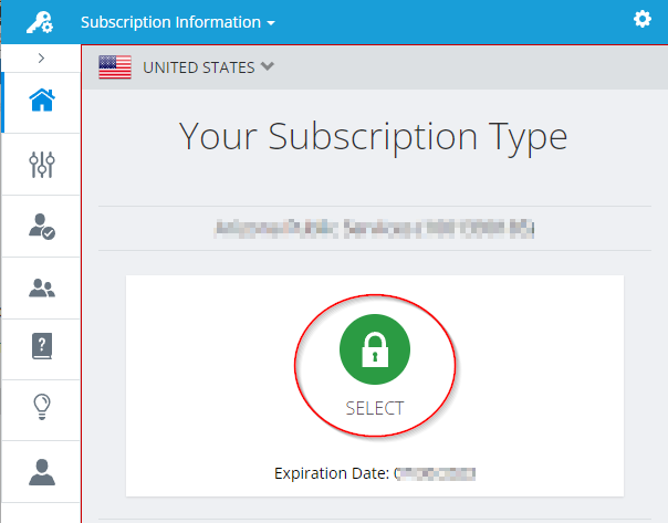

To change the default access setting, go to Entitlement Management and drill into the tile under "Your Subscription Type" (which may SELECT, Open Access, ELS, e365, etc.).

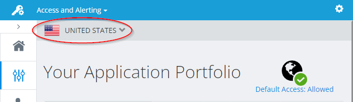

Choose the country you are managing from the top menu and to the right side of the screen you will see the Default Access icon informing you of the current setting.  Click on the icon to change the setting.

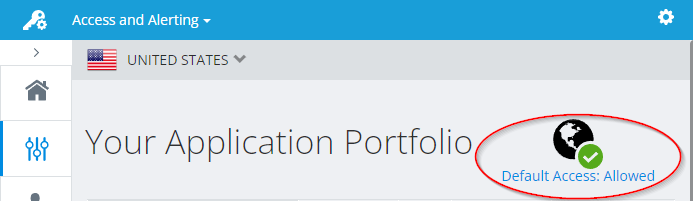

Drill into the Default Access Icon on the upper right part of the page

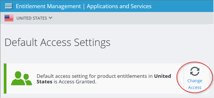

On the Default Access Settings page, choose Change Access.

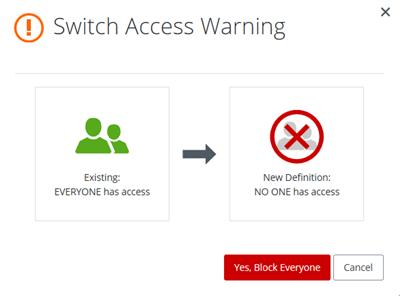

Click on the Yes button at the bottom of the dialog to confirm the change.

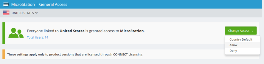

From the "Your Application Portfolio" page, click the General Access link for the product you want to change.
In the product's General Access page, click the drop-down on the Change Access button.
To create an override, or change the current override value, choose Allow or Deny, depending on the which behavior you require.
To remove an override, choose Country Default to restore the setting back to the current default setting.
