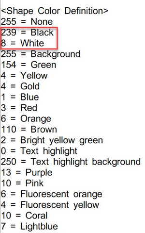

To control the colors used when an OpenRoads SignCAD sign file is open, placed or pasted using the SignCAD MDL, adjust the color table values in the <Shape Color Definition> section of the SignCADColor.def file to match the color table values used in MicroStation/OpenRoads Designer.

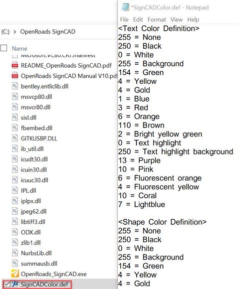

1) Open the SignCADColor.def file found in the C:\OpenRoads SignCAD folder in Notepad.

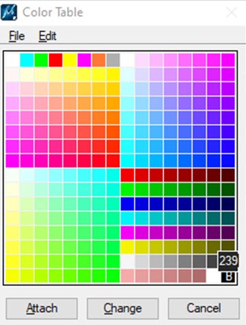

2) Adjust the color table numbers under the <Shape Color Definition> section of the SignCADColor.def file to match the Color Table numbers (ex: 239 = Black; 8 = White) and save your changes.
3) Close both OpenRoads SignCAD and MicroStation/OpenRoads Designer and then reopen them.
