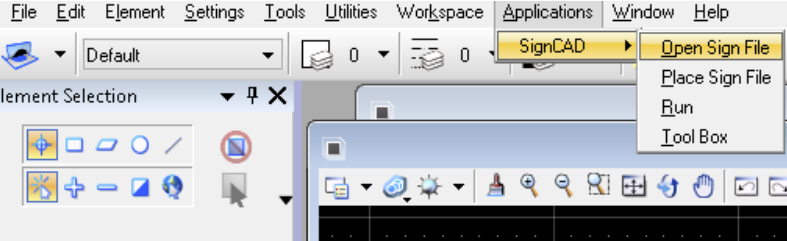

INSTRUCTIONS FOR USING THE SIGNCAD MENU
In Bentley V8i Products, the SignCAD Menu is available under Applications > SignCAD.

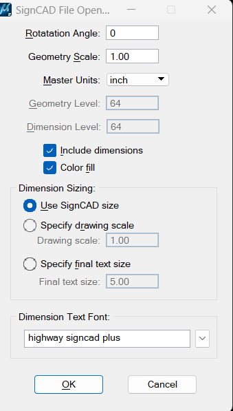

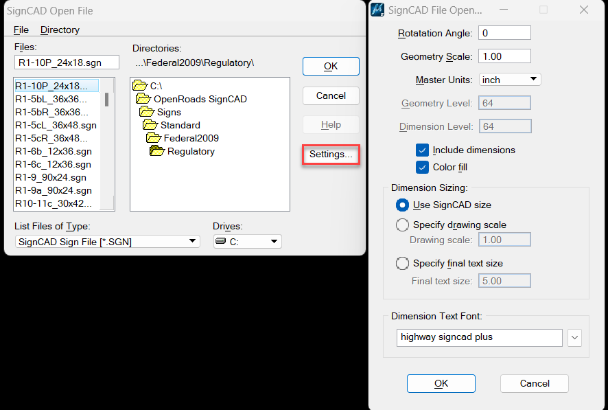

To “Open” or “Place” an OpenRoads SignCAD file in the Bentley V8i product, browse to the file location and select the SGN file. Click on the Settings button to define the parameters. Press OK to both dialogs.

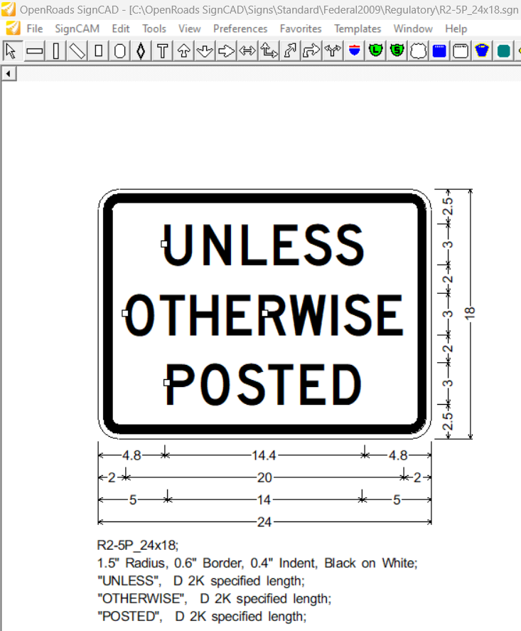

To copy/paste a file from OpenRoads SignCAD into a Bentley V8i application, select the sign in OpenRoads SignCAD (from the OpenRoads SignCAD menu: Tools > Select then window select the sign, Edit> Copy).

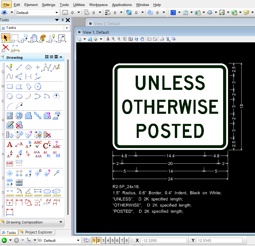

In the V8i application, pick Edit>Paste>SignCAD Sign to Design File.
Define the parameters in the SignCAD File Open Settings dialog and press OK. Left click to place the sign.
