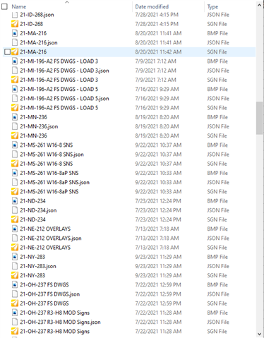

Question:
How do I prevent additional files (.json, .bmp and .sgn) from being saved in another directory on my computer or network drive?

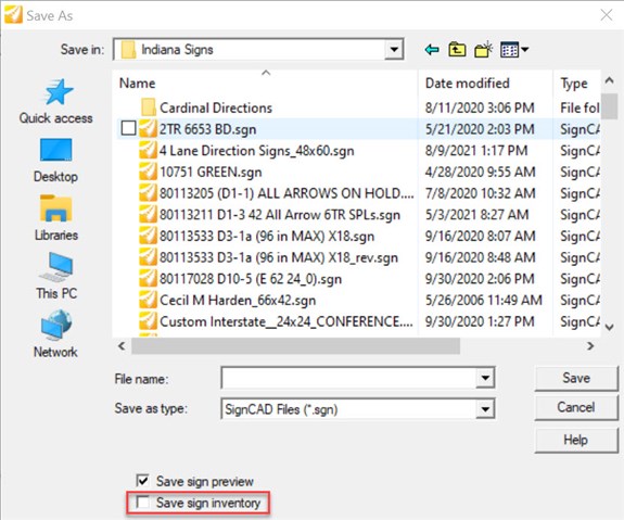

The Save As dialog in OpenRoads SignCAD has a "Save sign inventory" option that saves additional sign inventory files (.json, .bmp and .sgn) to another directory on the computer or network drive.
To prevent the additional sign inventory files from auto-saving to your computer or network drive, uncheck the Save sign inventory box in the Save As dialog box before saving your file.  Once you change this setting for the first time, then the program will automatically default to only saving the SGN file.
