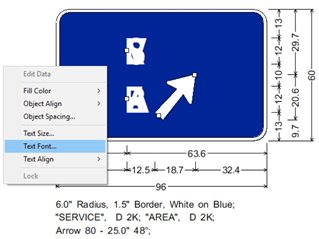

Text displays stacked
Text displays stacked in OpenRoads SignCAD.
1) Window select the text in the sign.  Right click and pick Text Font from the floating menu.
2) Select the font from the Text Font dialog box that matches the font shown in the dimensions below the sign and press OK.
3) Save the file (File>Save or File>Save As).
