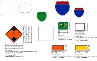

Text does not display in signs, shields and dimensions in OpenRoads SignCAD after installation.
