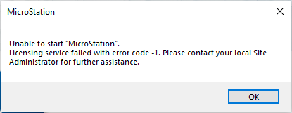

When opening a product, an error appears that includes the following message:
Licensing service failed with error code -1
Error message
Explanation
The Bentley Licensing Service, a background process responsible for retrieving licenses on behalf of products using our Subscription Entitlement Service, is either not running or is not functioning properly.

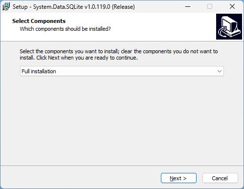

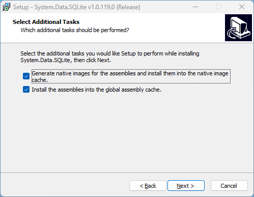

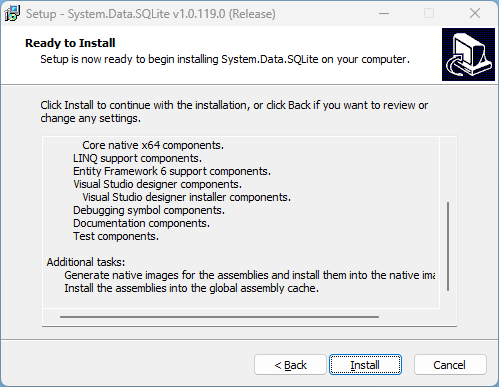

    Download, unzip, and install sqlite-netFx46-setup-bundle-x64-2015-1.0.118.0.exe.zip
Run the file and Select Full Installation and check "install the assemblies into the global assembly cache." box -
Restart the machine
