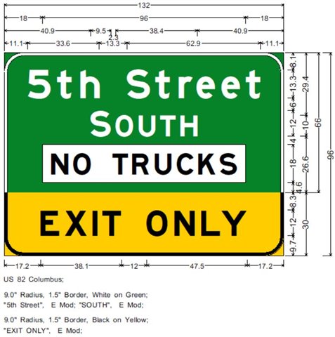

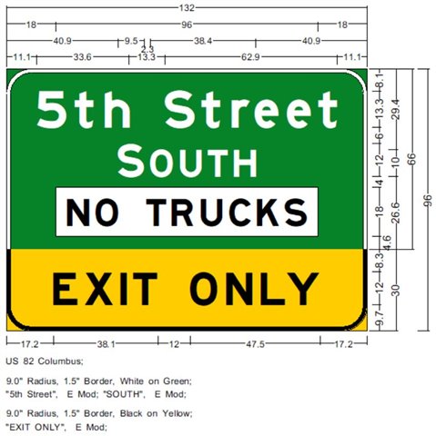

Dimension arrows do not display at the ends of the dimension lines
The dimension arrows do not display at the ends of the dimension lines on a sign in OpenRoads SignCAD.
The dimensions arrow display in OpenRoads SignCAD is set in the Dimension Style dialog box. Pick Preferences>Drawing. In the Drawing dialog, press the Style button. In the Dimension Style dialog, check the “Dimensions arrow” box and press OK to both dialog boxes. The dimension arrows should now display at the ends of the dimension lines.
NOTE: If the Dimensions arrow box is already checked in the the Dimension Style dialog box, then uncheck the Dimensions arrow box and press OK to both dialog boxes. Pick Preferences>Drawing>Style again and then check the Dimensions arrow box and press OK to both dialog boxes. The dimension arrows should now display at the ends of the dimension lines.
