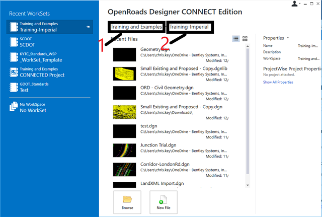

a. If crashing on startup after selecting a file to load, are you loading the program with a custom workspace?  The startup issues could be workspace related.
Try using a delivered workspace and workset to load the data.  When you are loading the DGN, it may state that the design file is associated to a workspace, which is ok.  You want to continue loading the file using the selected delivered workspace such as the 'Training and Examples' workspace and the 'Training-Imperial' workset.  If loading the program with a delivered workspace allows the program to open, you can start troubleshooting the custom workspace to see if there is a variable preventing the program from loading.  Refer to this link for information on Workspace Related Topics.

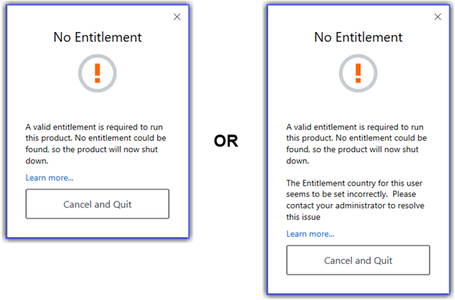

Error 1:  "A valid entitlement is required to run this product. No entitlement could be found so the product will now shut down."
Solution:  Refer to this article on Entitlement Issues

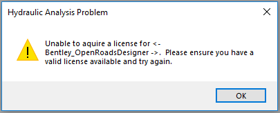

Error 3: Hydraulic Analysis Problem  -  "Unable to aquire a license for <-Bentley_OpenRoadsDesigner->. Please ensure you have a valid license available and try again."
Solution:  Chick HERE for information on this error.

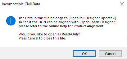

Error 4: "Incompatible Civil Data. The Data in this file belongs to [OpenRail Designer Update 8]  To see if the DGN can be aligned with [OpenRoads Designer] please refer to the online help for Project Alignment.  Would you like to open as Read-Only? Press Cancel to Close this file."
Solution: Refer to this article on how to perform Product Alignment using the Civil File Manager

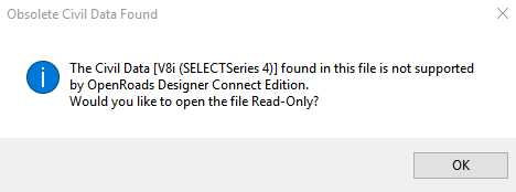

Error 5: Obsolete Civil Data Found:  The Civil Data [V8i (SELECTSeries 4)] found in this file is not supported by OpenRoads Designer Connect Edition.  Would you like to open the file Read-Only?
Solution(s) depending on product version:
OpenRoads Designer 10.06.xx - 10.08.xx  (Using the VersionChecker.exe):
OpenRoads 10.09.xx+ (Using the CivilFileManager.exe):
