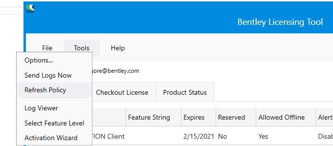

If you do not want to wait for the synchronization cycle, you can encourage users to manually refresh their policy file before opening a Bentley application. To manually refresh a policy file, the user needs to
1. Be logged into Connection Client
2. Open the Bentley Licensing Tool
3. Click Tools > Refresh Policy
Refreshing the policy file only takes a few seconds.

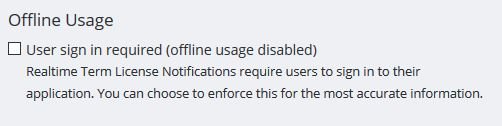

For each application, you may disable offline usage. To do this
1. Navigate to Licensing Alerting in Entitlement / License Management
2. Click on the application you need to disable offline usage for.
3. Check the checkbox underneath Offline Usage, which is near the bottom left of the page

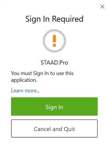

If this is checked, then users must have an internet connection and be signed into the Connection Client to use Bentley applications. If User sign in is required, users that do not have an internet connection will not be able to start their Bentley applications. Even if an admin unchecks this box, they will still not be able to start the application until the machine has connected to the internet to synchronize with the new policy. In this scenario, the only way for an offline user to start their Bentley application is if an admin creates a checkout and walks the policy file over to the user's machine.
User will see the below pop up
If offline usage has been explicitly disabled and an Internet connection is lost sometime after a product has been opened, the user will be alerted after three minutes of failed attempts to reestablish a connection. To avoid data loss, the alert advises the user to save work and close the product as soon as possible but does not force the product to close. Offline usage is then logged with a special ProductionOfflineDisabled status until the product is closed. It is imperative users heed this alert since such usage cannot be detected by our Usage Alerting Service.
