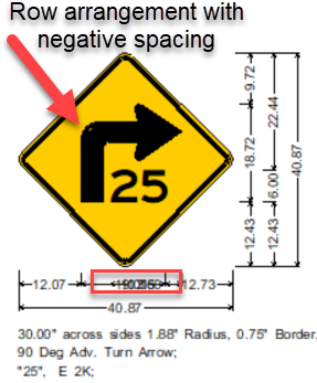

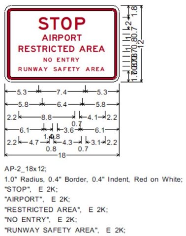

Sign dimensions overlap in OpenRoads SignCAD.
1) From the Preferences menu, pick Drawing.
2) In the Drawing dialog, reduce the Drawing Scale value.

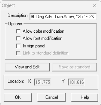

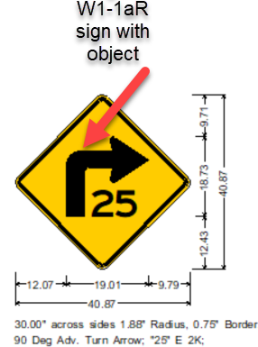

NOTE: If a specific Drawing Scale must be used or if reducing the Drawing Scale is not desirable, then another option is to select the individual elements and make them into an object (File>Create Object). Placing the object on the panel will only show the overall width and height instead of the individual dimensions. However, additional information can be added in the Object Description which will display in the object list below the sign.
