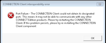

Problem Description
When signing in to the CONNECTION Client the following error occurs: The Connection client could not obtain its designated port.

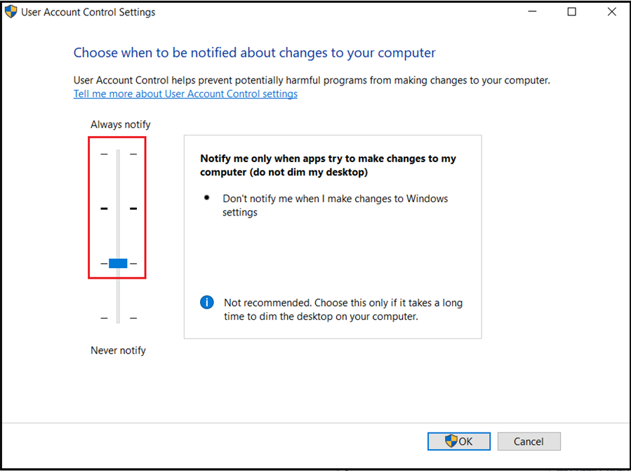

Checking the UAC Setting
The issue is typically due to using the CONNECTION Client on a shared environment/server where multiple users are remoting in or logging on simultaneously using Remote desktop or Citrix. To resolve you have to enable UAC (User Account Control) to any setting except for never notify.
