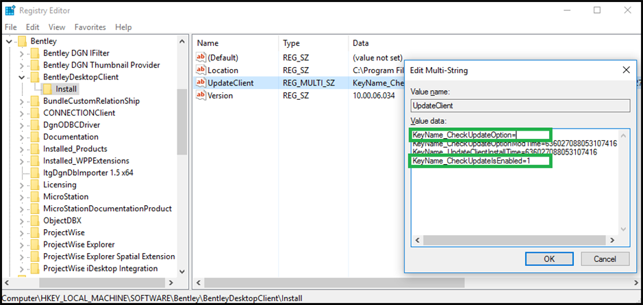

Silent Install with Updates permanently disabled
Use setup_connectionclientx64_11.00.xx.xx.exe BeCheckUpdateOption=3 BeCheckUpdateIsEnabled=0 /q
Use this option if you want to prevent users from seeing any updates available under "Applications" and disable the "Updates" option in "Preferences".
Location in the registry is the UpdateClient value in HKEY_LOCAL_MACHINE\SOFTWARE\Bentley\BentleyDesktopClient\Install
Change the values:

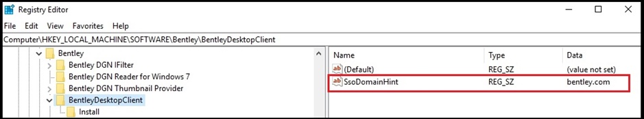

Set the IMS federation domain hint manually
Note: This requires you to be federated with Bentley's Identity Management System and is only required if the domain provided by your machine does not match the domain that set up for federation. You can check this by opening command prompt and typing "echo %USERDNSDOMAIN%". The returned value should match a domain federated with Bentley. You can check this by trying to sign in with that domain in a web browser on https://connect.bentley.com/. A federated domain will redirect you back to your server for authentication, rather then keeping you on the Bentley authentication page and prompting you for a password.
A domain hint kick starts the federation process by providing the federated domain in the initial request to IMS from the CONNECTION Client. This will automatically redirect the login screen back to your identity provider where the user will perform your method of authentication. Note that this does not guarantee that you will be automatically signed in at your identity provider.
setup_connectionclientx64_11.00.xx.xx.exe SsoDomainHint=mydomain.com /q (change mydomain.com to your domain name)
Location: HKEY_LOCAL_MACHINE\SOFTWARE\Bentley\BentleyDesktopClient

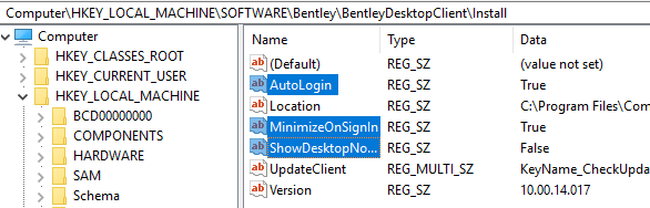

Managed Preference Settings
*Please note: Implemented in CONNECTION Client 10.00.14.xx or later
The following options can be specified in HKEY_LOCAL_MACHINE\Software\Bentley\BentleyDesktopClient\Install by an administrator to mandate preference settings used by CONNECTION Client. These can be viewed by a user in the CONNECTION Client Preferences window, but they cannot be changed:
Each of the string values above can have a value of either True or False.
