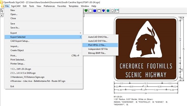

  1. Select the graphic and pick File>Export Selected>Plot HPGL-2 File.  Save the PLT file and press OK to the Export Plot dialog.

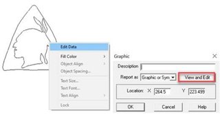

3. Right click on the graphic and pick Edit Data. In the Graphic dialog box, press the View and Edit button.

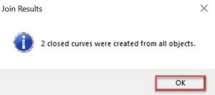

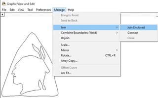

4. In the Graphic View and Edit, pick Manage>Join>Join Enclosed. Press OK to the Join Results dialog.

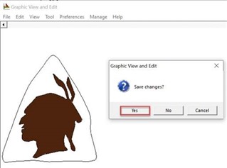

5. Add fill color to the graphic and save your changes (File>Close and "Yes" to save changes). Press OK to the Graphic dialog box.

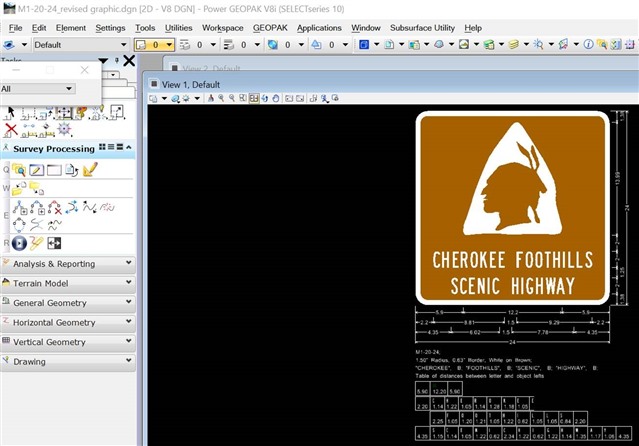

7. Use the SignCAD MDL to open, place or copy/paste the sign into the V8i application. In the SignCAD Open File dialog box, press the Settings button. Select the desired settings and press OK to both dialog boxes.
