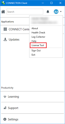

Option 1 - from CONNECTION Client
Using the 'License Tool' item in the CONNECTION Client drop-down menu (starting from version 11.00.05.34):
License Tool menu item in CONNECTION Client

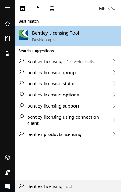

Option 2 - from the Windows Start or Search
1. Open the Windows Start menu.
2. Type "Bentley Licensing".
3. Select Bentley Licensing Tool from the search results that appear.

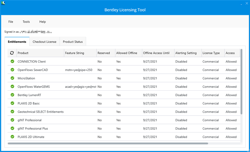

When the Bentley Licensing Tool opens it displays the Entitlements tab. If the CONNECTION Client is signed in, a Bentley login will appear in the upper left corner. Products appear in the Entitlements list if they have communicated with Bentley before. i.e. products that have ever been started on the machine before, and not only the entitlements the user has. They will communicate the following information:
 Screenshot of the Bentley Licensing Tool with Entitlements tab active

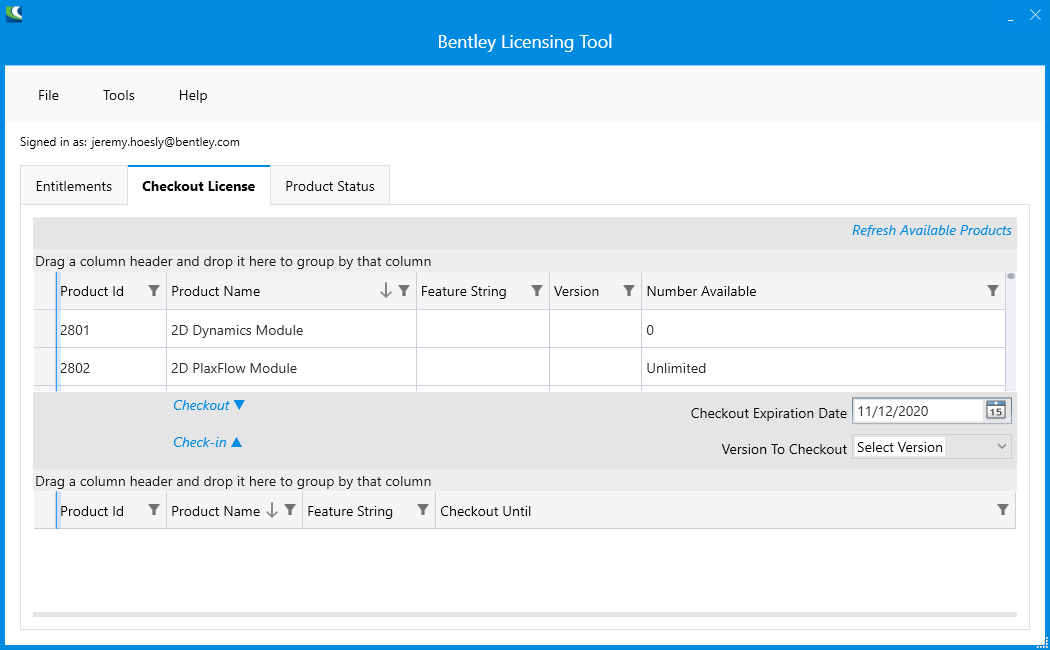

Checkout License Tab
Product licenses can be locked to the computer for extended use apart from an Internet connection.
Screenshot of Checkout License tab

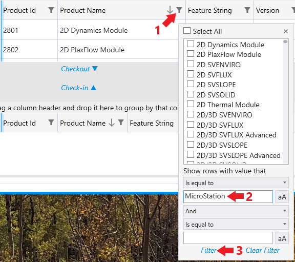

The top pane provides a list of licenses. Although it shows two rows by default, the window can be made taller by dragging the window handle in the lower right corner. Additionally, columns can be filtered by clicking the filter icon as shown below.
Screenshot demonstrating product filter

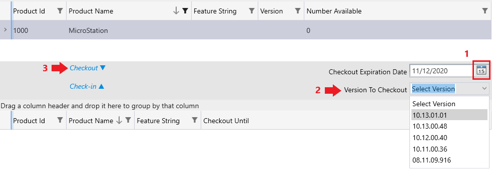

To check out a license:
1. Select it in the top pane.
2. Specify an expiration date using the calendar icon located along the right edge.

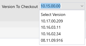

3. Select a valid version from the list or manually enter the four part version number corresponding to the version of your product.
Demonstration of manual version entry
4. Click the Checkout button.
Screenshot of checkout expiration and version
The bottom pane displays a list of licenses locked to the computer.
To check in (return) a license:
To return a license prior to the expiration date, select it in the bottom pane, and click the Check-in button above.

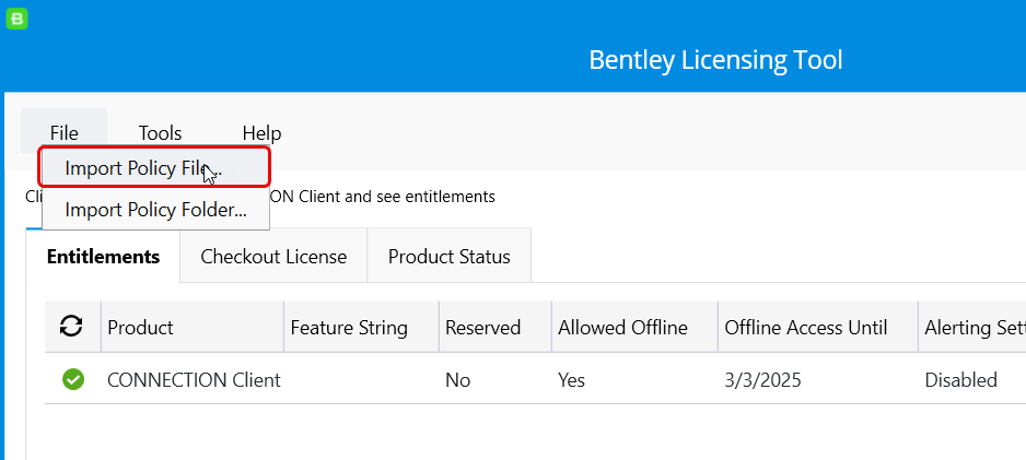

Licenses can be checked out from the Entitlement Management site on behalf of a user and saved as a file. The Licensing Tool provides two options to import checked out license files: Import Policy File or Import Policy from Folder
Option 1: To import a file, select "Import Policy File..." from the File menu, and select either a .belic file or a zip archive containing .belic files (generated from a bulk checkout). If there are multiple .belic files in the zip file, the import will search for the current machine name in the .belic file names to decide which license file to import.
Option 2: To import from a folder, select "Import Policy Folder...: from the File menu. Use the browse dialog to choose the folder where the checked-out license files are stored. Again, if there are multiple .belic files in the fold, the import will search for the current machine name in the .belic file names to decide which license file to import. This folder does not need to be a local file system folder; it can be on a shared network drive.
After the import, a dialog will confirm whether the license file imported successfully. Click the Sync button on the Entitlements tab as shown below to refresh the list.
If successful, the product with the imported license will display "Yes" in the Reserved column.

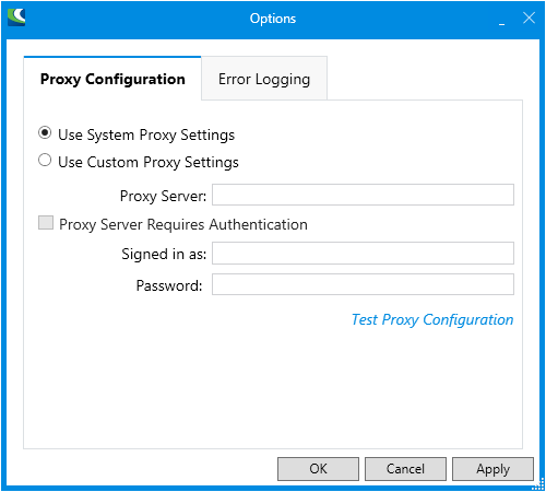

Starting with CONNECTION Client 10.00.18.13, Subscription Entitlement Service products can now utilize system proxy settings as configured in the Internet Options control panel. However, proxy settings can be manually configured if necessary:
1. Select Options from the Tools menu.
2. For most users, ensure the "Use System Proxy Settings" radio button is selected on the Proxy Configuration tab that appears. For server or test environments where proxy settings must be manually configured, choose the "Use Custom Proxy Settings" radio button instead.
3. If specifying custom proxy settings, enter the computer name of the proxy server. If a port must be specified, append the server name with a colon (:) and the port number (i.e. ProxyServer:8080). To determine what proxy settings (if any) are in use, please refer to the following wiki, specifically the section titled "Determine whether a proxy server is in use."
Note: PAC files are not supported in custom proxy settings.  If you need to use a PAC file, please apply that in the System proxy settings.
4. If user authentication is required as well, select the second checkbox, and enter user credentials.
5. Click the Test Proxy Configuration link in the lower right to confirm proper configuration.
6. If the configuration test is successful, click the OK button to save changes.

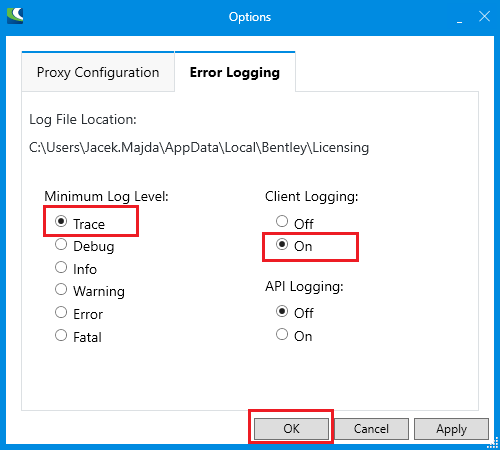

Configuring Error Logging Settings
Subscription Entitlement Service provides diagnostic logging to assist with troubleshooting efforts. By default, the Bentley Licensing Tool maintains a detailed rolling log that is sufficient for most troubleshooting, but configuration options can optionally be configured using the following steps within the Bentley Licensing Tool:
2. Click the Error Logging tab.
3. The Minimum Log Level shows the level of detail to capture. Trace is the default selection which captures all diagnostic information. Each selection below Trace captures less diagnostic information. Lower levels allow diagnostic information to be captured over a greater time span before the oldest diagnostic data is deleted.
4. Client Logging is disabled by default. Enable it to capture additional diagnostic information for each Subscription Entitlement Service application.
 Enabling error logging

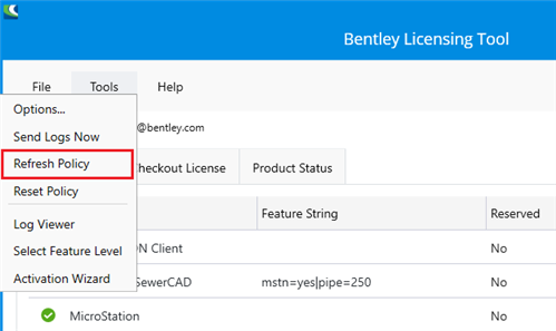

Refresh is available in all versions of CONNECTION Client. This is for expired policies or when a new policy is needed manually (auto refreshed occurs every 4 hours).
Refresh Policy in the Bentley Licensing Tool

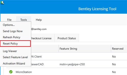

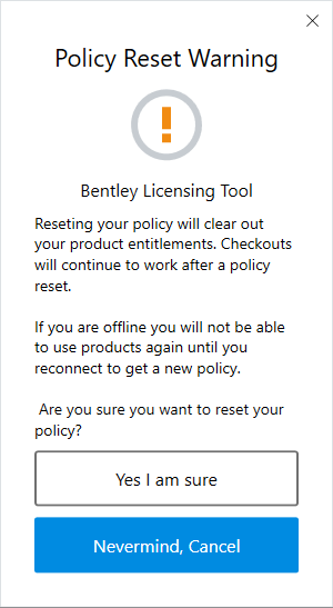

Reset is available in CONNECTION Client 11.00.3.14 or newer. Resetting the policy will empty your entitlements tab and will force a new policy next time an application is used. This option is useful for license troubleshooting or for clearing old licenses.
Reset Policy in the Bentley Licensing Tool
Click the "Yes I am sure" button to proceed.
Screenshot of Policy Reset Warning
