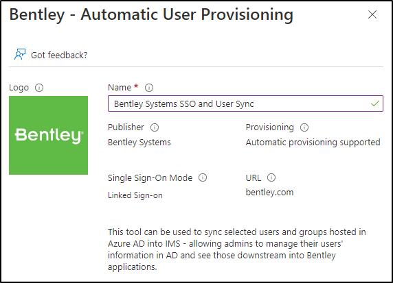

4. Search "Bentley" and click on the Bentley application:
5. You may keep the name of the application, rename it to reflect your own preference, or rename to "Bentley Systems SSO and User Sync" to reflect that this app will be used for both.
6. Select "Create" at the bottom of the page on the right. After a few moments the page will automatically redirect you to the enterprise application that was just created to support this work. This also created an app registration with the same name at the same time.

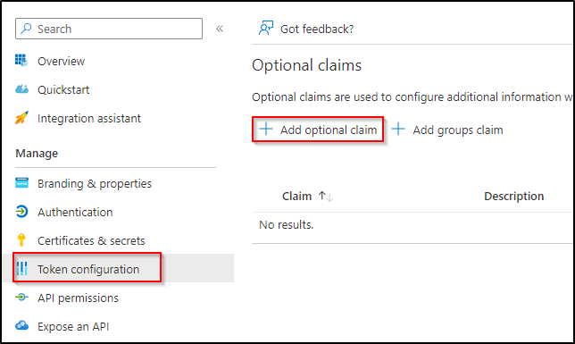

4. On the left-hand side go to "Token configuration" and select "Add optional claim" to set up the details we will receive in your id_token.

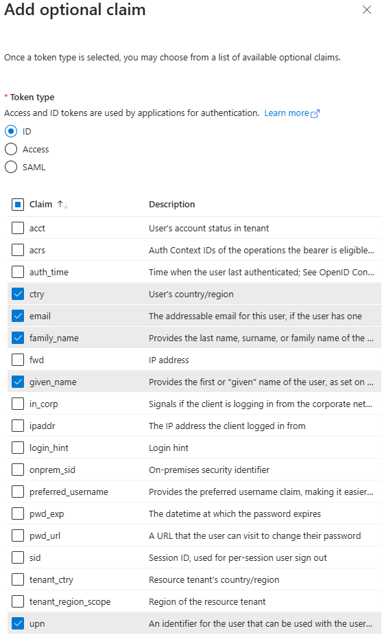

5. Select "ID" as the token type. From the menu that populates, select "ctry", "family_name", "given_name", "upn". Then hit add. A pop up will prompt for the Microsoft Graph permissions required to access these details. Click the checkbox to grant the permission, and hit addSelect "ID" as the token type. From the menu that populates, select "ctry", "email", "family_name", "given_name", "upn". Then hit add. A pop up will prompt for the Microsoft Graph permissions required to access these details. Click the checkbox to grant the permission, and hit add. Please work with us to determine the appropriate identifier for looking up users on our end, whether email address or User Principal Name (UPN).

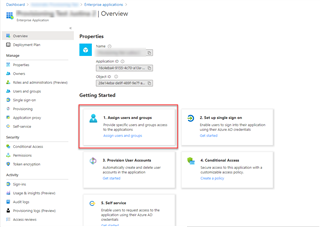

  1. Open the application and click "Assign users and groups" from an Overview page
  1. On the opened page click “+ Add User"
  1. Click on the “Users and groups” section and choose users or groups that you want to synchronize into the Bentley system, select and click “Assign”.
Users and groups will be synchronized on the next provision run.

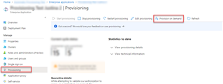

VIII. On-Demand Provisioning (Users Only)
1. Go to Provisioning section of the application in the Azure Portal:
2. Click On-Demand Provision. A new page should open:

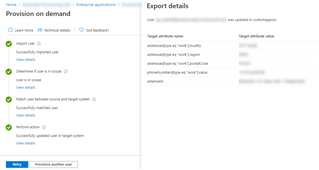

3. Enter the user you want to Provision/update Attributes and click Provision:
4. The user should be provisioned instantly and the results are shown on the same page.
