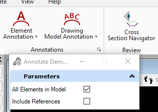

The Drawing Model Annotation is used to annotating Drawing Models such as those created by the Create Named Boundary/Create Drawings command (i.e. Cross Sections/Plan/Profile drawings).  This command will not work in a Design model.
If you wish to annotate elements in a Design Model, such as Survey features in a 3D Design Model, then run the Element Annotation command and select "All Elements in Model" in the Annotate Elements dialog.
