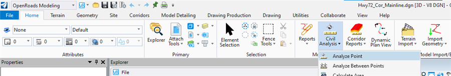

In the OpenRoads Modeling workflow, select the Home ribbon and then in the Model Analysis & Reporting group, select Civil Analysis>Analyze Point :

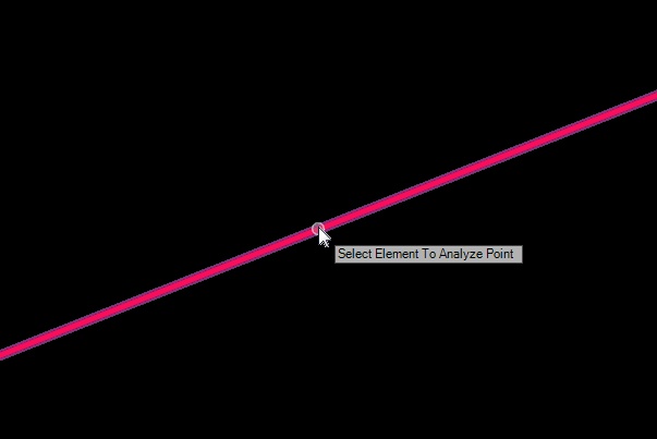

When prompted, select the horizontal element you wish to track:

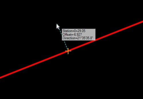

Once selected, you will be able to view tracking information as you move the cursor along the alignment:
