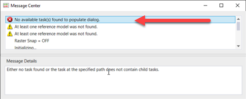

Trying to load v8i theme, specifically the task menu in dialog mode. When I hit the dialog button nothing shows up and the message center reads "No available task(s) found to populate dialog.".
How can I resolve this?
Answer:

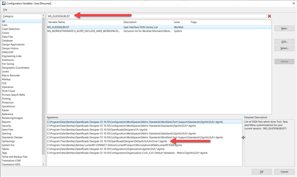

To enable the V8i task theme dialogue your workspace needs to point to the proper dgnlib. In the Bentley workspace, we deliver the "v8iTasks.dgnlib". To resolve the problem, ensure that the "MS_GUIDGNLIBLIST" points to the directory that contains this library file.
You can check this variable settings in your workspace, by first opening a dgn in your workspace the navigating to File>Settings>Configuration>Configuration Variables and searching for "MS_GUIDGNLIBLIST". In the Bentley Metric workspace this file is found in the highlighted directory below:
