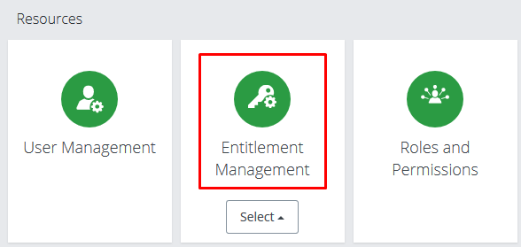

2. Click on the Entitlement Management tile under Resources:

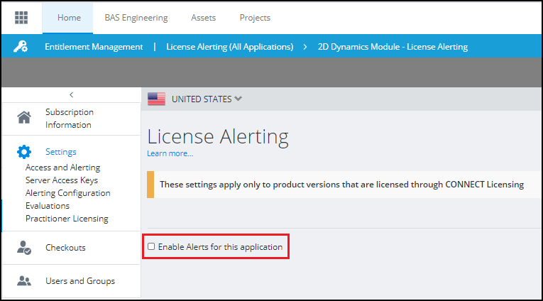

4. Select 'License Alerting' for an application that you want to enable alerts.  Usages that are Unlimited can have a value set if needed. Repeat the following process for additional applications.
Step 2: Enable Alerting
1. Once the application is selected, toggle on 'Enable Alerts for this application'.
*Please note: Alerts are disabled by default.
2. The available options are now displayed and can be set as needed.

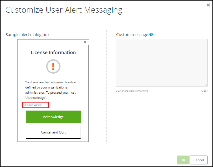

When a user receives an alert, it has a default message indicating that the license threshold has been reached. You may use the Customize User Alert Messaging link to create an additional custom message. For example, you may indicate the license threshold or suggest a person at your organization to contact.

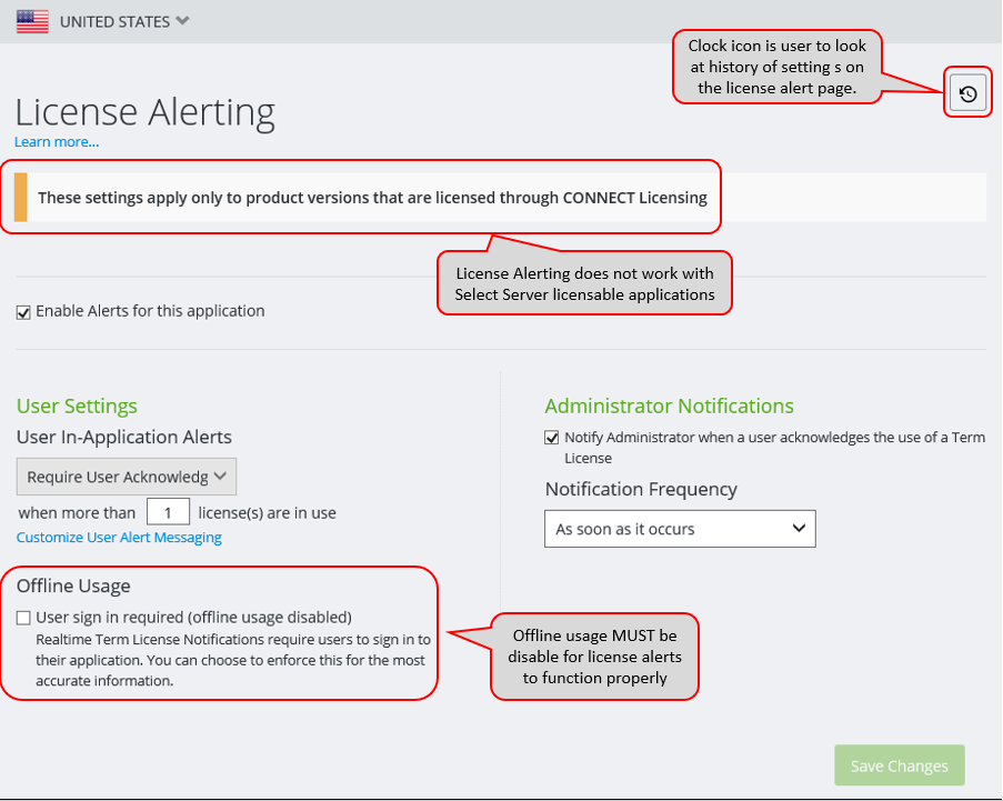

1. These are the options that can be set:
a. User In-Application Alerts - forces the user to acknowledge that they are bypassing the alert.
b. The number of licenses that are in use when the alert message will be displayed.  This can be set to any value.
c. Offline Usage - By default, products can be used offline if a user is unable to sign in. However, users may unknowingly exceed the value set in the license alert while working offline since the computer cannot check with the license alerting service first. To avoid this problem, administrators can disable offline usage.
d. Administrator Notifications - A notification preference can be set for when a user overrides the alert message, so that a Admin knows as it happens or in a daily report.
e. Custom User Alert Message - The Admin can create a custom message that is displayed when the alert value is triggered.  This can be helpful in providing user guidance and a contact. When the user selects 'Learn more...' they will see the custom message.
IMPORTANT NOTE:
Enabling or disabling either usage alerts or offline usage require a policy refresh on the client side to apply the changes. Client machines automatically refresh their policy files every four hours while signed in or when restarting CONNECTION Client, but changes can be applied immediately by opening the Bentley Licensing Tool and selecting Refresh Policy from the Tools menu.
Changes to the quantity field under User In-Application Alerts do not require a refresh on the client end.

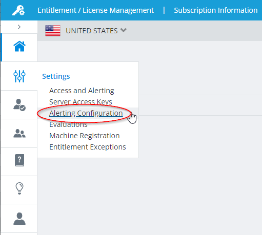

        1. Navigate to the Settings in left pane and go to Alerting Configuration .

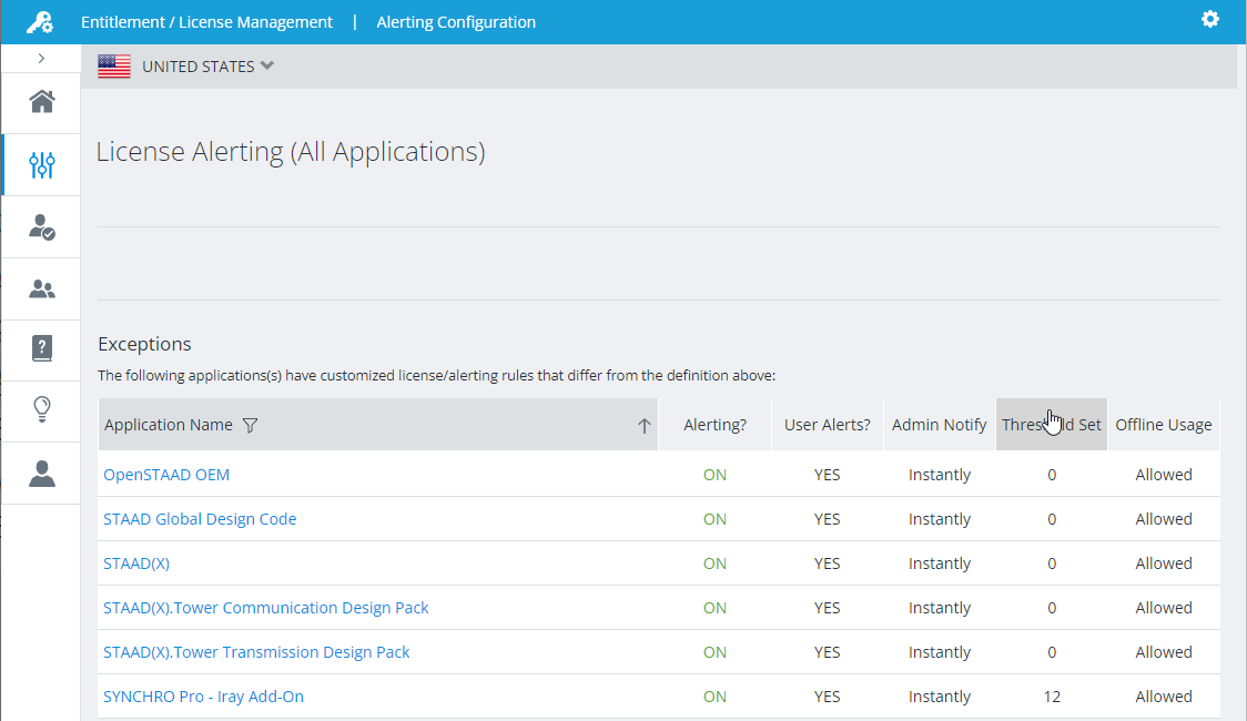

3. Once alerting has been configured for products, you can review your settings by selecting 'Alerting Configuration'
